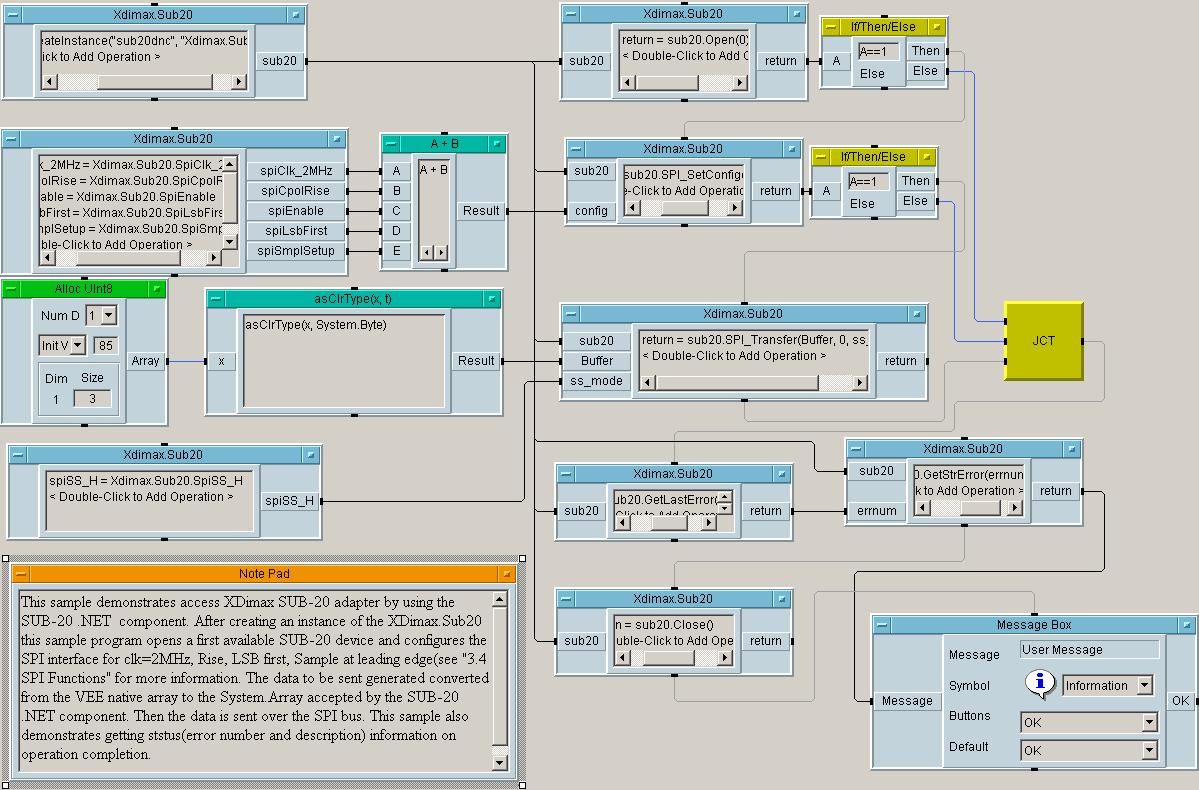

This VEE Sample demonstartes using of the SUB-20 SPI interface.

SPI VEE sample program

The VEE is sensitive to the location of the SUB-20 .NET component(sub20dnc.dll). It must be installed into the GAC (Global Assembly Cache). This can be done by using the gacutil.exe utility:
gacutil.exe -i C:\Program Files\SUB-20\bin\x86\sub20dnc.dll
