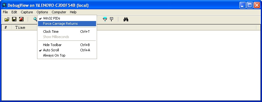

1. Install and run DebugView utility
DebugView can be downloaded from Microsoft SysInternals.
http://technet.microsoft.com/en-us/sysi ... 96647.aspx
To run it simply execute the DebugView program file (dbgview.exe).
2. Make sure to uncheck Options->Force Carriage Returns

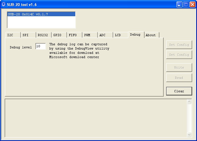

3. Run SUB-20 tool and set Debug Leve = 10
