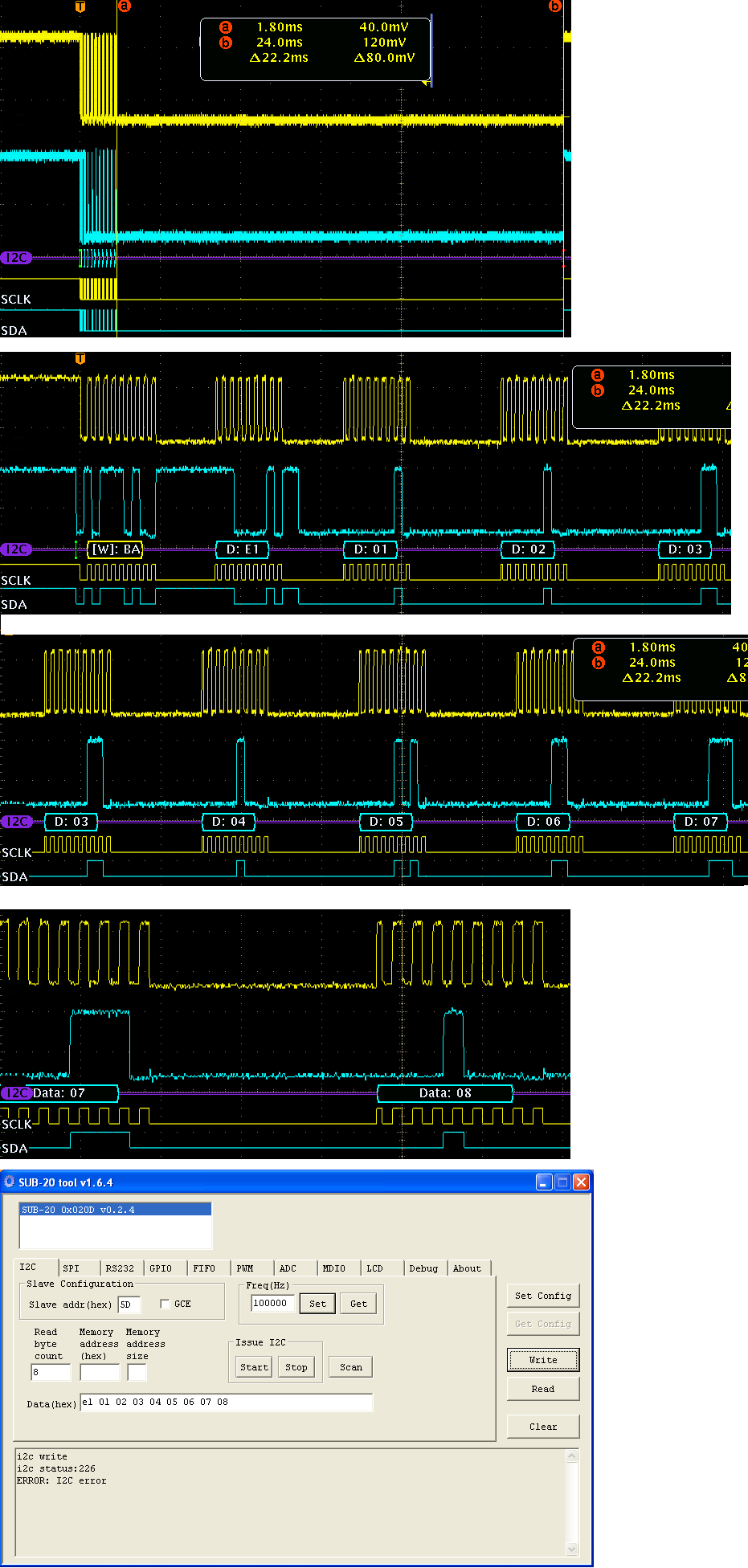

Here are some depictions of the waveform and finally a screenshot.

Previously it was stated that the timeout was 5 seconds, but now you say 500mS. A 5 second timeout would be preferable, this should handle all future possibilities.

From the waveform it is not clear where exactly the clock stretching begins. I assume that after last data byte 0x08 is written your slave is starting to hold the clock low? Is it correct?
Re: I2C Timeout
Posted: Thu May 06, 2010 3:41 pm
by gwh
That is correct.

Well this is a very strange place to stretch clock. Usually clock stretching happens before ACK or during data write.
I have extended STOP condition timeout as well. Please try attached firmware.
