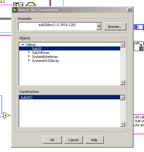

Hello,
I want to use LabView 7.1 via .NET to development my application that will use the Sub-20. I have already ordered a sub-20 but haven't received it (just ordered last night). I installed "SUB-20-100923-x32.exe." I have a newer version of labview and used it to open the LabView SPI demo and then save the demo for LabView 7.1. I fixed a few minor problems (relinking the dll, etc), but there is still one error remaining. There is a .NET constructor called "Spi" with parameter "Ss_HHL" that is wired to the Sub20/SPI_Transfer_r ss_mode node -- see figure.
What is this "SPI" constructor? what dll is it attached to? when I add a new constructor and point to the sub20dnc.dll then I only get the objects "Sub20" "Sub20Enum" "SystemByteArray" and "SystemInt32Array".
Any thoughts?

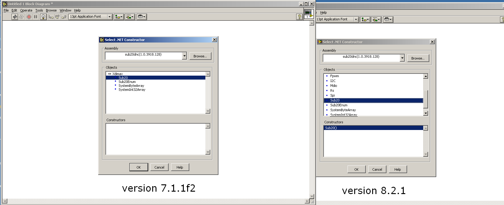

Btw:
I just looked at the sub20dnc dll in LabView 8.0 and there is a "Spi" constructor. Why doesn't this show up in Labview 7.1? I do need to use LabView 7.1 for my application because it will be deployed in a location that only has license for 7.1.

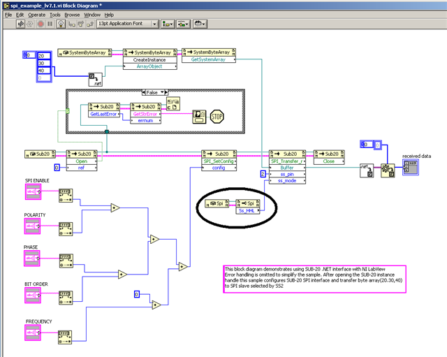

hi Brad
I don't know why LabView 7.1 behaves differently. We didn't test the SUB-20 with LabView 7.1.
The Spi class is a just set of constants related to the SPI interface. Similarly the sub20 .NET component contains constants for fifo, pwm, adc, gpio etc. These classes contain just constatnts, no methods. So you can simply calculate(oring) the desired value and put it as a constant into your vi. You can find all the numeric vaues in the C header file located under C:\Program Files\SUB-20\inc\libsub.h. Here is SPI SS mode constants taken from this file
So, in your case just connect constant value of 10(decimal) as a ss_mode

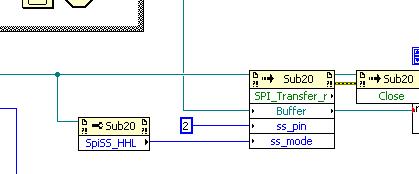

By the way our constant container classes are not static, hovewer we do have static constants in the sub20 class. May be you can access those somehow. Here are some of them
For example, do you see the sub20.SpiClk_250kHz constant from inside the LV 7.1?
I can use these constants in LV 8.5 by choosing the "Connectivity->.NET->Property Node"

Hello,
I am still waiting for my SUB-20 but spent a bit more time with the drivers. I can access the constants using the "Property" node and was able to display the numeric values of the SPI constants on my front panel in LV71. However, the overall behavior of the .NET interface is a little rough compared to when using LV 8.2. For example, LV8.2 seems to automatically convert the ".NET Constructor" into the ".NET Property" node if the SPI constants are selected. Additionally, LV7.1 tends to 'forgot' the install directory of the sub20dnc.dll and I often get dll not found errors on execution but LV8.2 doesn't have this problem. I copied the .NET dll into the same directory as the VI I am executing and LV7.1 behaves much better (ie it doesnt have trouble finding the dll when I execute the VI).
I upgraded to 7.1.1 and installed the f2 patch and the behavior is pretty much the same. Best advice I have is to copy the dll into the same directory and use the correct constructor/property/invoke object. I will try to provide an update once I get my hardware.

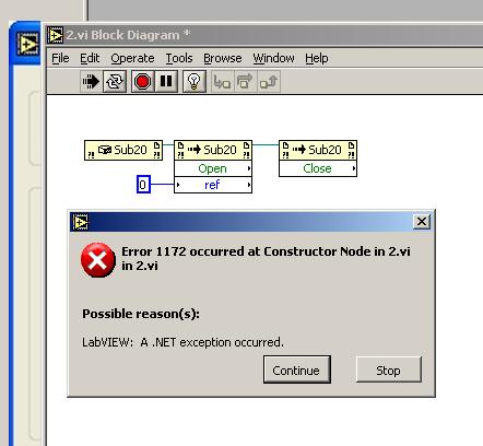

Ok I got the hardware today. I am still having problems with using the Sub20 .NET interface in LV7.1.
I started LV7.1 and created a new VI. I dropped a ".NET Constructor Node" on the wiring diagram and the constructor dialog box appeared. I navigate to sub20dnc.dll and in the "Objects" window choose the "Sub20" under "Xdimax." I push OK and the wiring diagram comes back, however the .NET constructor icon still says ".NET" instead of "Sub20." In 7.1, the available constructors are not showing. I made figure comparing the behavior of LV7.1.1f2 and 8.2.1. In 8.2.1 the Sub20() constructor appears, but it doesnt in LV 7.1.1f2.
I am able to access the class properties via the ".NET Properties Node" in LV7.1.1f2, but this doesn't get me very far.
I am able to access the constructor methods of other classes in LV7.1.1f2, I just can't access the ones for sub20.

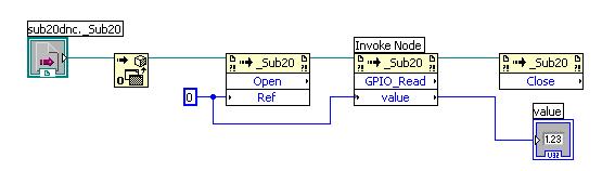

hi brad,
Thank you for the update.
I couldn't find the LV7.1.1f2 directory. I have installed LV7.1 on XP SP2, udated to 7.1.1 and finally applied the f2 patch, however I still cannot access the .NET component. I get the following exception when I try to execute the vi
But I got the LV7.1 working with the board by using a different approach. The sub20.dnc is a dual interface module, i.e besides the .NET interface it exposes a .NET predecessor - activex interface. In order to use this interface you have to create so called type library and use this sub20dnc.tlb file as a normal activex control. See the sub20.net document for details about creating the type library. So in case you still have problems try this method. I have attached my simple vi which uses the sub20dnc as an activex control.
