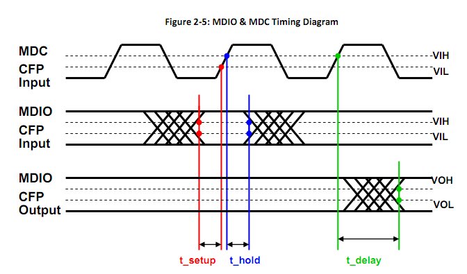

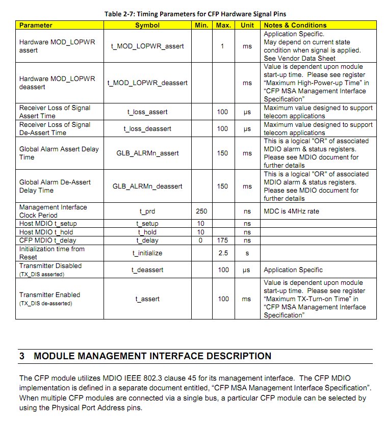

We have some arguing about right interpretation of the specification. The question is WHEN Host (in our case it is SUB-20) should scan MDIO line referenced to MDC rising edge. Here is some background.
This is taken from CFP MSA Rev 1.4
and

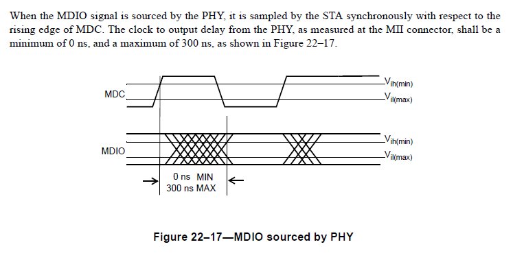

As you can see CFP MSA reference to IEEE 802.3 Clause 45.
1. t_delay of 0..175ns is a delay between rising edge of MDC and stable MDIO. Is it correct?
2. To support all kinds of PHY's Host should scan MDIO 175ns after rising edge om MDC right?

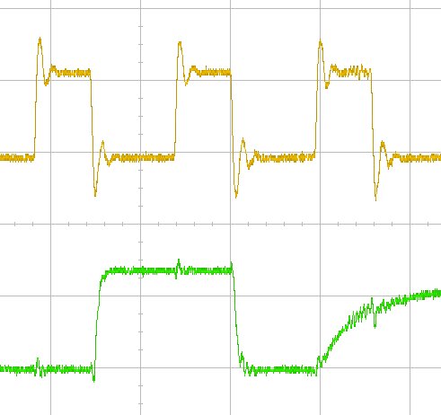

3. We have some customer with t_delay = 0ns. But MDIO on their implementation is stable for only 65ns after MDC rising edge and if we scan MDIO after 175ns we get wrong data. Do you think such implementation is compliant with a spec?
This is the illustration. SUB-20 reads the last bit as "1" but customer says it should be "0". Who is right?
Yellow signal is MDC
Green signal is MDIO
