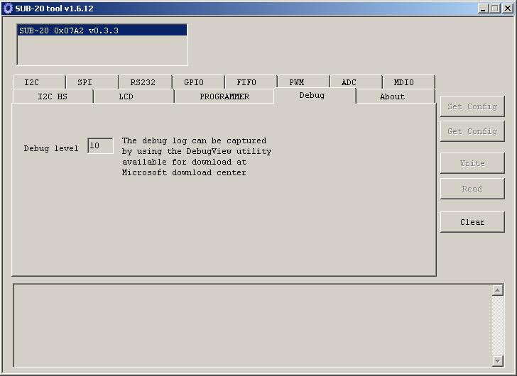

1. Run the SUB-20 tool application, switch to the "Debug" tab and set the "Debug Level" to 10.
You can also call the sub_set_debug_level function or the SetDebugLevel .NET method from your code to set the DebugLevel to desired value. The maximum value is 10. This value is stored in a memory of the loaded instance of the sub20.dll, therefore don't close this application until you finish with the debugging. Also, having multiple sub20.dll instances on a same system may cause a situation when the DebugLevel is set in one instance and debugging application is using different instance of the sub20.dll. The best practice is to have only one instance of the sub20.dll, located in the Windows\System32 directory or Windows\sysWOW64 directory if 32-bit SUB-20 package installed on a 64-bit system.

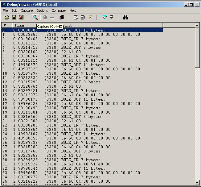

2. Run the DebugView utility and make sure that Menu->Options->Force Carriage Returns is "unchecked"
3. Run your application until an error or a weird behavior happens
4. Click the "capture" icon or press Ctrl-E to stop the capturing
5. Save the log into a file (Menu->File Save As)
Here is an example of the trace log
