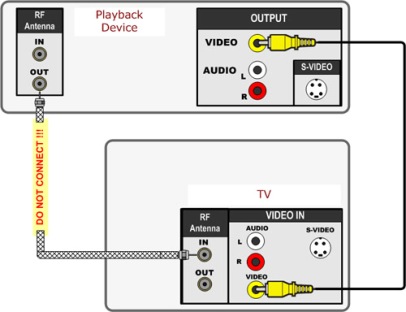

Step 3:
Make a connecion between your source playback device and TV as shown below:
If you can't see playback from playback device on your TV, then there is something wrong with your equipment.

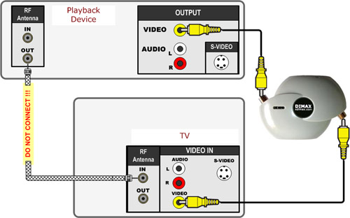

Step 4:
Connect GREX between your playback device and TV, as shown below:
If you still can see playback on TV from your playback device, then GREX is OK.

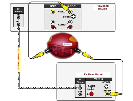

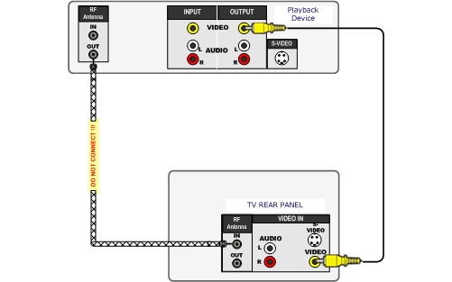

Step 3:
If you can't see playback from source device on your TV, then there is something wrong with your equipment.
Step 4:
Connect DVD Red Pro between your playback device and TV, as shown below:
If you still can see playback on TV from your playback device, then DVD Red Pro is OK.
